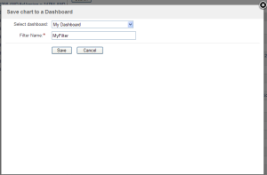

Adding Gadgets to your Dashboard
To create a chart based on your search results and display it on your dashboard (note that this process will also create a saved filter):
  1. View the desired search results in your Issue Navigator.
  2. Click the 'Views' menu, and select 'Charts'.
  3. Your search results will be displayed as the default chart. If you wish to select a different type of chart, you can change the chart and chart settings as described in Viewing a Chart above.
  4. Click the 'Save to Dashboard' button. The 'Save chart to a Dashboard' screen will display as shown below (click to view larger image).
  5. Select the dashboard to display the chart on in the 'Select dashboard:' field and type a name for your search results in the 'Filter Name' field, then click the 'Save' button. The chart will now appear as a gadget on your dashboard.
  6. If you wish, the gadget can be repositioned on the dashboard through the dashboard configuration page.
