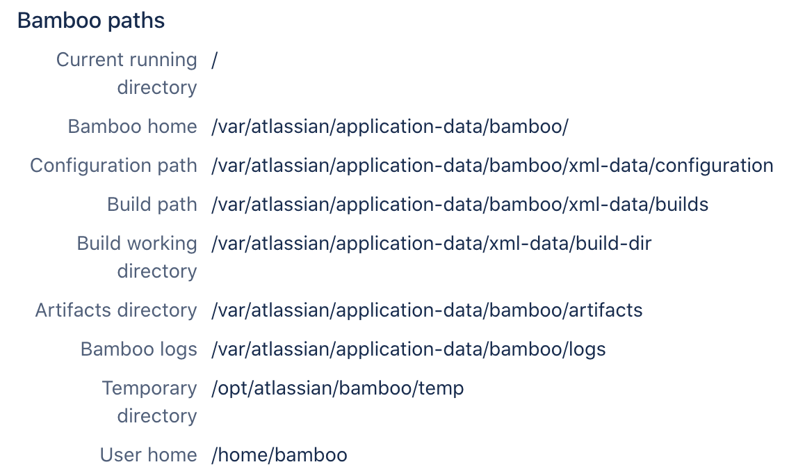

Viewing Bamboo paths
Select cogwheel icon  System > System information > Bamboo paths. Note the Bamboo home path, Build path, and Configuration path:
Bamboo paths section
For more information about these directories, see Important Directories and Files.
