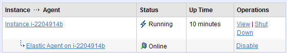

    3. Once your elastic instances have started up, they will progress to Running status. An elastic agent process will then start up for each instance. They will display a status of Pending while they start.
      Elastic instance with agent pending
    4. Once the elastic agents have started, they will display a status of Online.
