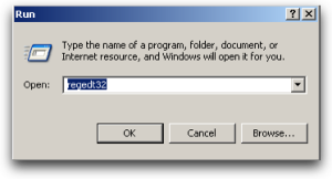

  1. Go to {{Start >> Run, and run "regedit32.exe".
  2. Find the Services entry:
    32-bit: HKEY_LOCAL_MACHINE >> SOFTWARE >> Apache Software Foundation >> Procrun 2.0 >> Confluence
    64-bit: HKEY_LOCAL_MACHINE >> SOFTWARE >> Wow6432Node >> Apache Software Foundation >> Procrun 2.0 >> Confluence
