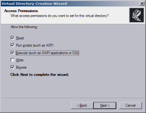

- Using the IIS management console (Internet Information Services in Administrative Tools), add a new Virtual Directory to your IIS web site. The name of the virtual directory must be jakarta, as it must correspond with the first part of the extension_uri setting specified in the isapi_redirect.properties file. Its physical path should be the directory where you placed isapi_redirect.dll (in the example it is

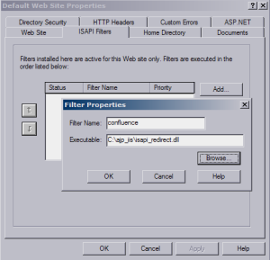

C:\ajp_iis). When creating this new virtual directory, give it execute access as well. - Using the IIS management console, add isapi_redirect.dll as a filter to your IIS web site. To do this, right click on the Web Sites icon from the left hand pane of the Internet Services Manager (or IIS management console), select Properties and then the ISAPI Filters tab. The name of the filter should reflect its task, for example confluence, and its executable must be the full path to the ajp isapi redirector DLL, that is c:\iis_ajp\isapi_redirect.dll

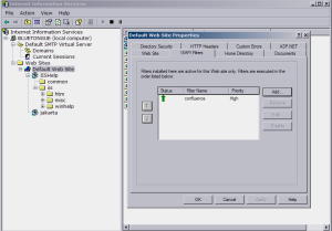

- Restart IIS (stop and start the IIS service - not just the web server -- do this by right-clicking on 'Local Computer' in the IIS Manager and choosing All Tasks, Restart IIS...). Ensure that the confluence filter is marked with a green up arrow verifying that it is loaded and initialized correctly. If the ajp redirector did not initialize properly, check the log file for errors messages (C:\ajp_iis\ajp_plugin.log).
