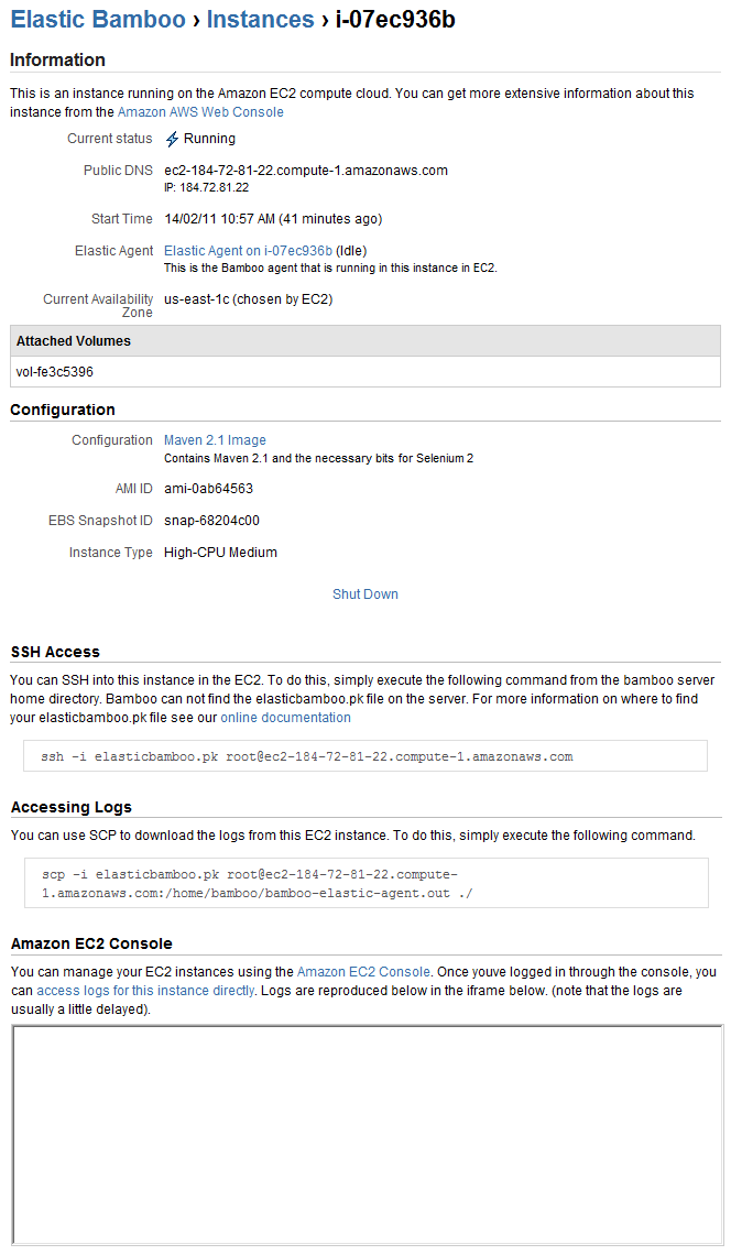

To view an elastic instance:
Click the name of the instance that you want to view, e.g. 'i-05ff716c'.
| 現在のステータス | The status of the elastic instance. Values include, 'Pending' (instance starting up), 'Running' and 'Shutting down'. |
| Public DNS | The public DNS address of the elastic instance. The IP address of the elastic instance is displayed here. |
| Start Time | The start time of the instance, based on the Amazon EC2 timezone (US Eastern Time for Elastic Bamboo). Start time is the time when you sent the request to start an instance, not the time when the instance progresses to 'Running' status. Up time of the instance (including the time taken for the instance to start up) is shown in brackets after the start time. |
| エラスティック エージェント | The elastic agent process currently running on your elastic instance. Currently, Elastic Bamboo only supports one elastic agent per elastic image. Click the link to view the elastic agent. If the agent is running a job, the job's key will be shown in brackets after the elastic agent name. |
| Current Availability Zone | The availability zone that your elastic instance is running in. Read more about Amazon EC2 availability zones. Your availability zone preference is shown in brackets after the current availability zone. For instructions on how to set the availability zone for your instances, please see Managing your elastic image configurations. |
| Attached Volumes | The IDs of the attached EBS volumes, if you have configured your elastic instances to use EBS. |
| 構成 | The name of the elastic image configuration that was used to create this elastic instance. Click the name to configure the elastic image. |
| AMI ID | The ID of the elastic image (i.e. Amazon Machine Image) that the elastic instance was created from (as part of the elastic image configuration). |
| EBS スナップショット ID | The ID of the EBS snapshot that was used to create the EBS volumes attached to your instance, if you have configured your elastic instances to use EBS. bamboo.agent.elastic.ebsVolumeSupervisionIntervalInSeconds |
| インスタンス タイプ | The instance type of your instance. |
| SSH アクセス | Please see Accessing an elastic instance for information on using this function. |
| Accessing Logs | Please see Accessing an elastic instance for information on using this function. |
Screenshot: Viewing an elastic instance
