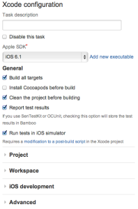

To configure a Xcode to test an iOS project task:
Complete the following settings:
| タスクの説明 | A description of the task, which is displayed in Bamboo. |
| このタスクを無効化 | オンまたはオフにすることで、選択的にこのタスクを実行します。 |
| Apple SDK | The Apple SDK to target during the build. |
| Report test results | Report and store any OCUnit/SenTestKit results run during the build. |
| Run tests in iOS simulator | Provides the RUN_UNIT_TEST_WITH_IOS_SIM variable used in the custom build phase to run the unit tests on the simulator. |
