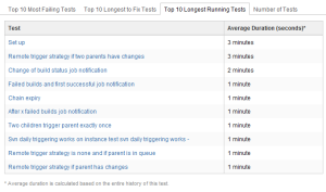

  3. The plan's 'Top 10 Most Failing Tests' sub-tab will be displayed. Click the other three sub-tabs to view the plan's 'Top 10 Longest to Fix Tests', 'Top 10 Longest Running Tests', 'Number of Tests' (see screenshots below).
    • To view a test's history, click the test name.
Screenshot above: Test Statistics for a Job
Screenshots above: Test Statistics for a Job - Tabs
