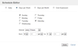

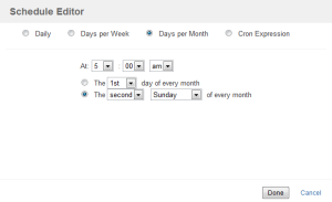

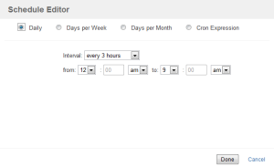

  5. In the Schedule Editor, select the type of polling schedule that you want to configure for your repository:
    • 'Daily' — Polls at specified intervals during the day, every day. For example, daily every 3 hours from 12:00am to 9:00am.
    • 'Days per Week' — Polls at specified intervals during the day, on specified days of the week. For example, each Sunday and Saturday every 3 hours from 12:00am to 9:00am.
    • 'Days per Month' — Polls at a specified time during the day, on specified days of the month. For example, the second Sunday of every month at 5:00 am

Screenshots: Scheduling polling for changes
