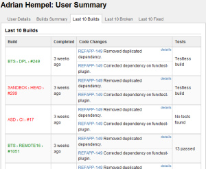

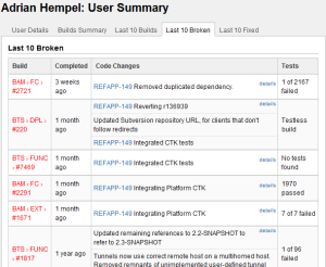

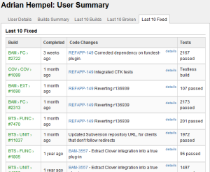

  4. Click through the following tabs to view recent build results:
    • 'Builds Summary' — a statistical summary of all the author's builds.
    • 'Last 10 Builds' — a list of the last 10 builds that were triggered by this author.
    • 'Last 10 Broken' — a list of the last 10 builds that were triggered by this author, where the build failed and the previous build for the same plan was successful.
    • 'Last 10 Fixed' — a list of the last 10 builds that were triggered by this author, where the build was successful and the previous build for the same plan failed.
Screenshots above: Viewing an author's build results (click to view larger images)
