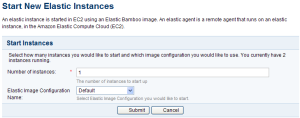

  3. Click the 'Start New Elastic Instances' link. The 'Start New Elastic Instances' screen will display (see screenshot below).
    • Enter the number of new elastic instances you would like to start in the 'Number of instances' field.
    • Select the elastic image configuration that you would like to start your instance from in the 'Elastic Image Configuration Name' dropdown.
      Screenshot: Starting elastic instances (click to view full-size image)
  4. Click the 'Submit' button. The 'Manage Elastic Instances' page will display, showing the startup of your new instances, as follows:
