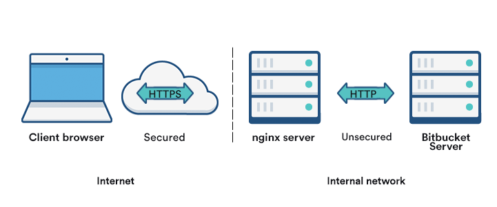

This page describes how to establish a network topology in which the nginx server acts as a reverse proxy for Bitbucket Data Center. Typically, such a configuration would be used when Bitbucket is installed in a protected zone 'behind the firewall', and nginx provides a gateway through which users outside the firewall can access Bitbucket.
このページに記載されている構成は、次のシナリオの結果を示しています。
  • External client connections with nginx are secured using SSL. Connections between nginx and Bitbucket are unsecured.
  • Bitbucket and nginx run on the same machine.
  • Bitbucket is available at https://mycompany.com:7990/bitbucket.
