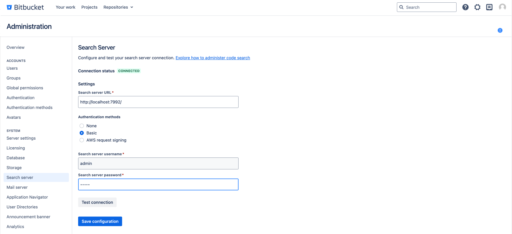

To change the connection details for accessing the search server from the Bitbucket UI...
Go to Administration > Search server
Here, you can see the search server's current configuration, including the URL and different authentication methods for accessing it.
