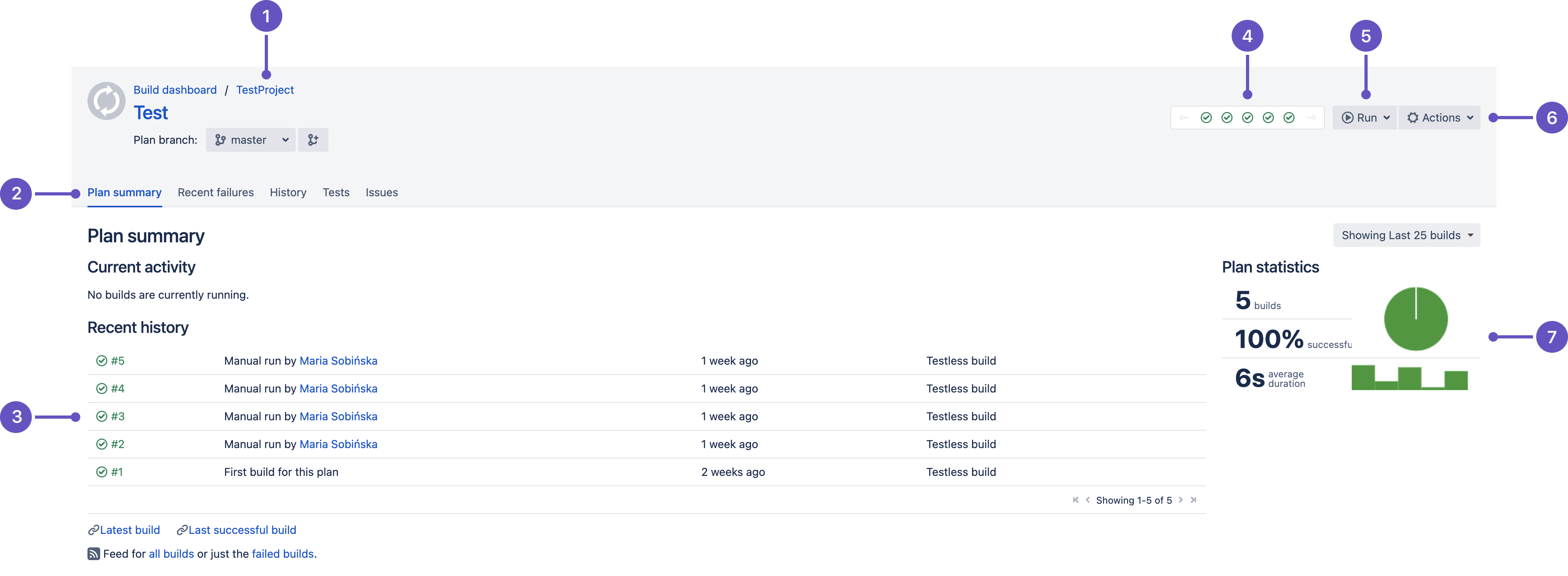

  1. Navigation: Select the project to view a summary of its plans.
  2. Tabs: View further details for the plan.
  3. Current activity and recent history: See whether the plan is building. Shows results for the ten most recent plan builds. Select a build number to view that build result.
  4. Plan status: Icons show if the plan is building and the status of recent builds. Select an icon to see the build result.
  5. Run menu: Select options for running the plan, e.g., run a parameterized build.
  6. Actions menu: E.g., Configure plan or Disable plan.
  7. Statistics and charts: For the build history of the plan.
