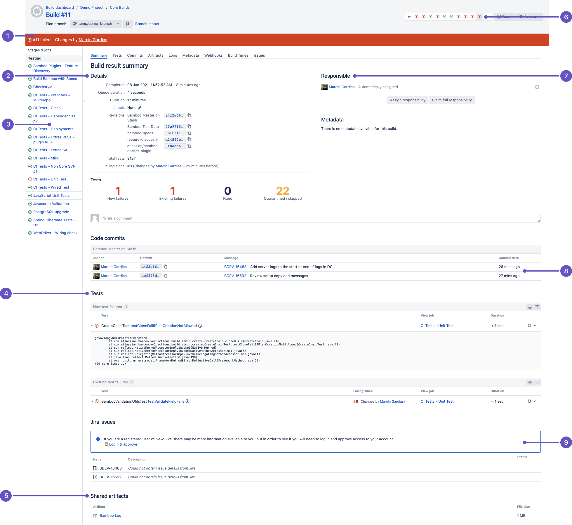

Build result summary screen
  1. Status ribbon: Did the build succeed or fail?
  2. Details: Scan details of the build easily.
  3. Stages and jobs in the plan: Scan the success of job builds. Select an icon to see details.
  4. Test summary: Quickly see how many test are failing and how many were fixed in this build.
  5. Shared artifacts: See the artifacts shared from this build and download them.
  6. History: Scan the status of recent builds.
  7. Who is responsible? Users who commit code are automatically assigned.
  8. Code changes: See the code changes associated with this build.
  9. Jira issues: See the JIRA issues related to this build. Select to go to the issue in Jira for details.
