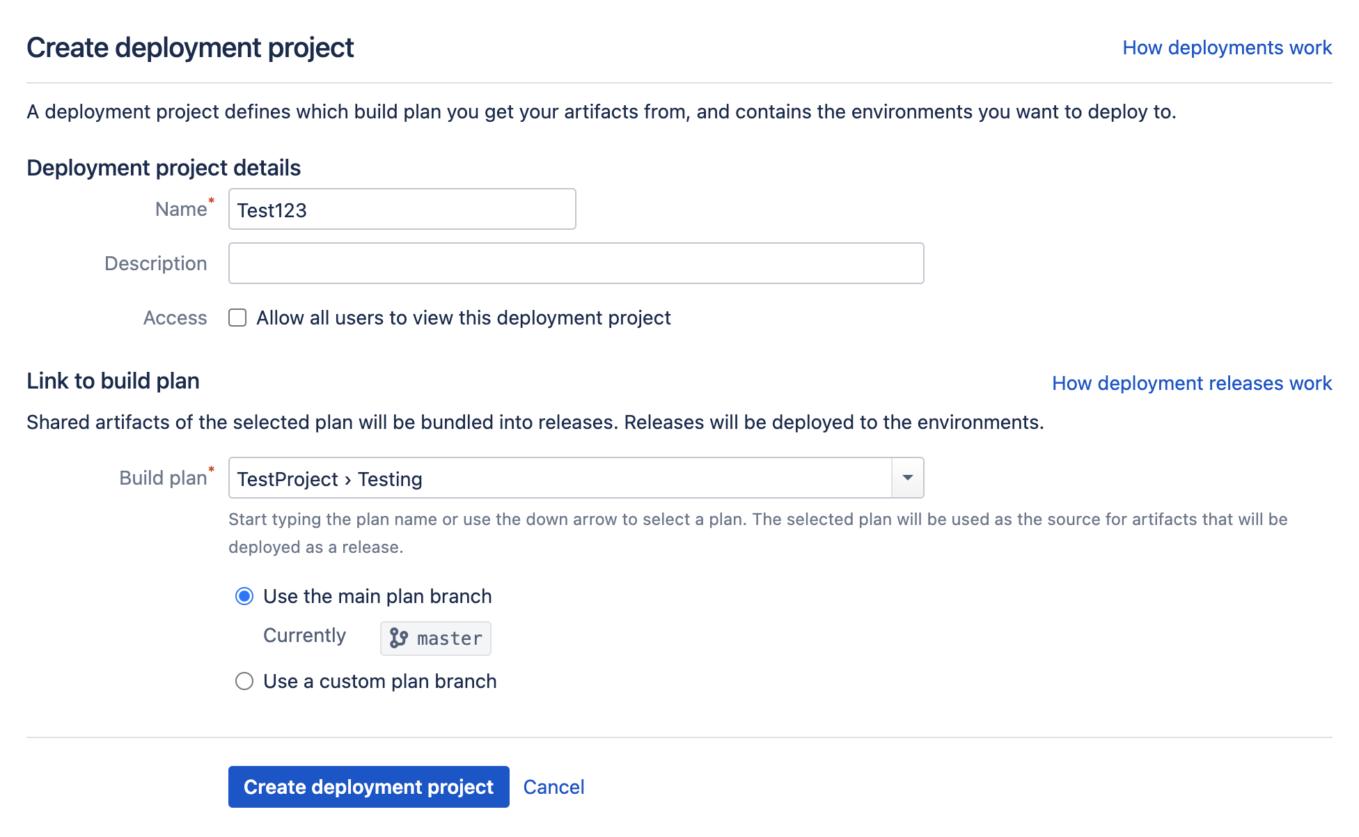

  1. Select Create > Create deployment project in the menu from the top navigation bar. If your build plan has a plan branch, Bamboo will detect it and offer an additional field for completion.
    Create deployment project screen
  2. Complete the Create deployment project screen using the following fields:
    フィールド説明 Optional?
    名前The name of your deployment project.(error)
    説明 A brief description of your deployment project.(tick)
    アクセスSelect the checkbox to make the deployment project visible to all users.(tick)
    ビルド計画The name of the plan you wish to associate with the deployment project. This field identifies the source of your deployment artifacts.(error)
    Use the main plan branch/Use a custom plan branchThe plan branch that you wish to deploy. Bamboo will auto detect available plan branches for you.(error)
  3. Select Create deployment project.
    Deployment project configuration page
    Your deployment project has been created with the build plan relation, name, and description you specified. It is now ready for configuration.
