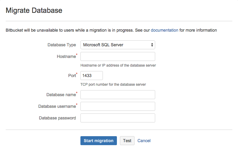

When migrating to SQL Server
  1. In the Bitbucket administration area, click Database (under 'Settings').
  2. Click Migrate database.
  3. Select SQL Server for Database Type.
  4. Complete the form. See the table below for details.
  5. Click Start Migration.
ホスト名
The hostname or IP address of the computer running the database server.
ポート
The TCP port with which Bitbucket can connect to the database server. The default value of 1433 is the default port that SQL Server runs against. You can change that if you know the port that your SQL Server instance is using.
データベース名
The name of the database that Bitbucket should connect to.
Database username
The username that Bitbucket should use to access the database.
Database password
The password that Bitbucket should use to access the database.
