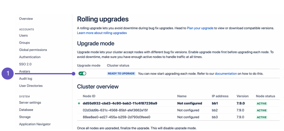

  1. Go to  > Administration > Rolling upgrades.
  2. Select the Upgrade mode toggle (1).
Enabling upgrade mode allows your cluster to accept nodes running a later bug fix version. This lets you upgrade one node and let it rejoin the cluster (along with the other non-upgraded nodes). Both upgraded and non-upgraded active nodes work together in keeping Bitbucket available to all users.
You can disable Upgrade mode as long as you haven’t upgraded any nodes yet.
