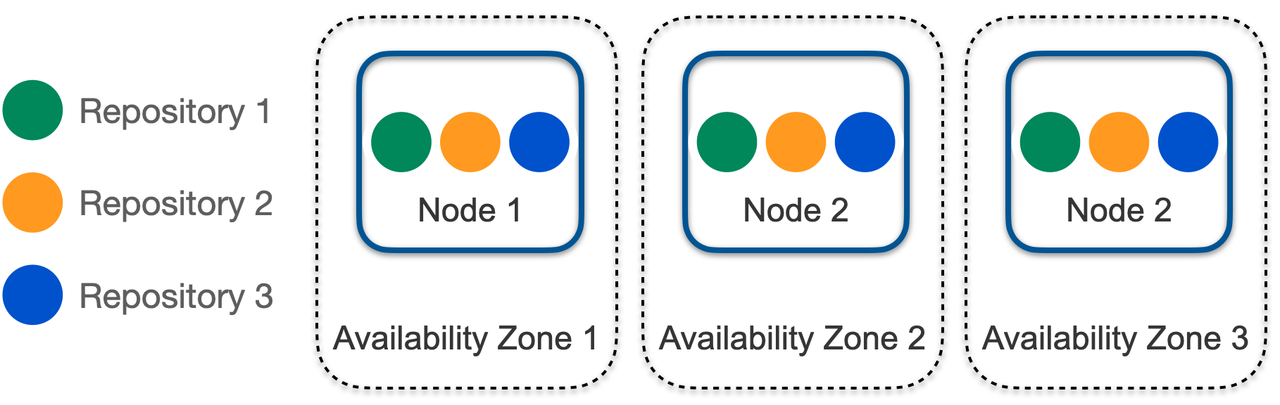

Mesh offers High Availability by replicating your Git repositories across registered Mesh nodes. The number of replicas for a repository is called the replication factor, and is set to 3 by default.
Availability Zones unlock a new level high availability through the distribution of your Bitbucket Mesh nodes housing your Git repository data across nodes hosted in multiple availability zones. When Bitbucket Mesh nodes are all assigned to multiple availability zones, you can be confident that your Git data is spread across them in a way that ensures high availability - you will be able to access them if nodes in a single availability zone experience failure.

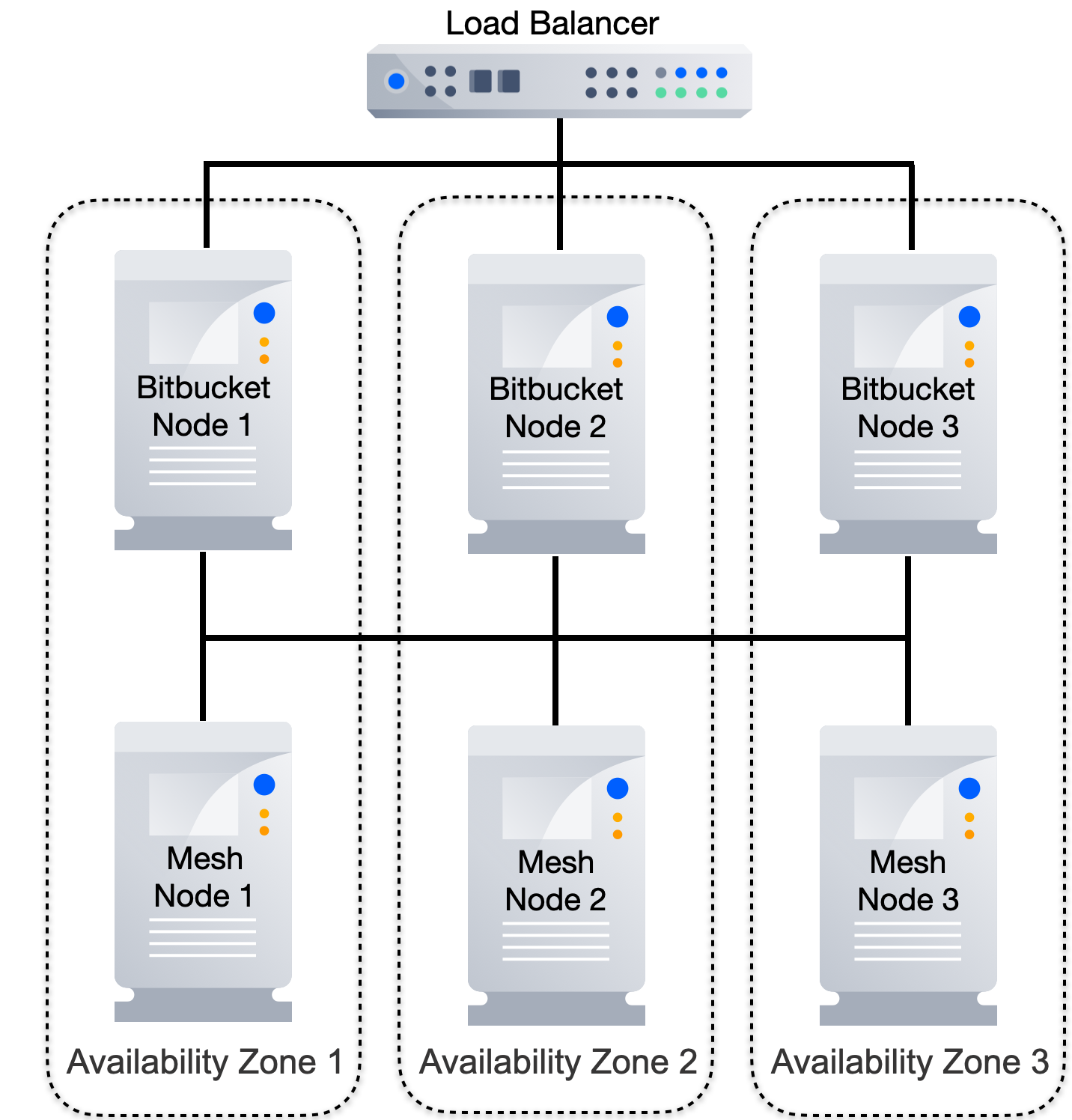

Bitbucket Mesh supports multi-availability zones deployed through cloud providers like AWS, Azure and also availability zones hosted on your own on-premises network. The following diagram shows a Multi-AZ deployment of Mesh nodes and Bitbucket Instances
A multi availability zone deployment of Bitbucket DC and Mesh nodes
Replication of repositories across Mesh nodes running in different availability zones
Deploying application nodes to various availability zones is supported once all repositories have been migrated to Mesh. The additional latency experienced between the app and Mesh, as well as between the app and database, may have a marginal impact on Bitbucket performance.
We recommend you to consider the trade-offs involved when opting for a high availability deployment.

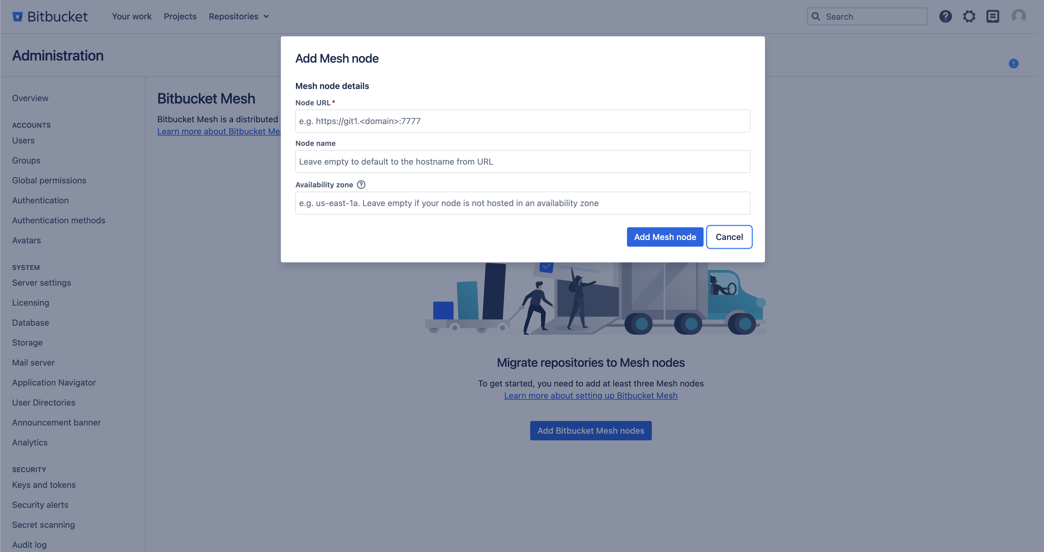

  2. Select Add Bitbucket Mesh node
    Registering a new Bitbucket Mesh node
    Once you register your Bitbucket Mesh node, its availability zone can’t be changed without deleting it from your Bitbucket Mesh cluster and Bitbucket Data Center instance.

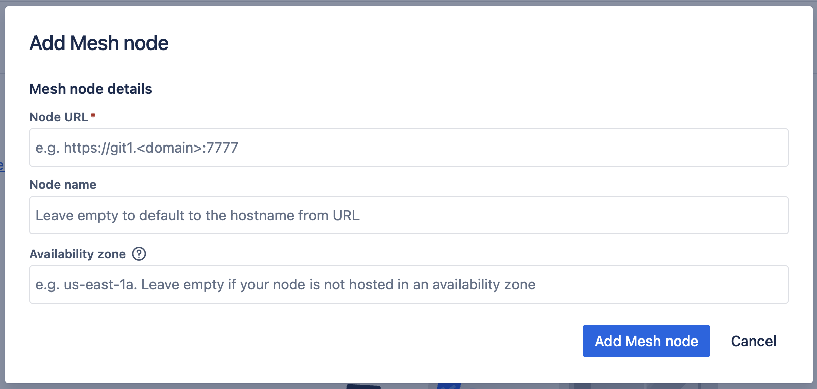

  3. Enter the Node URL, Node name and Availability Zone information
    Bitbucket Mesh registration dialog

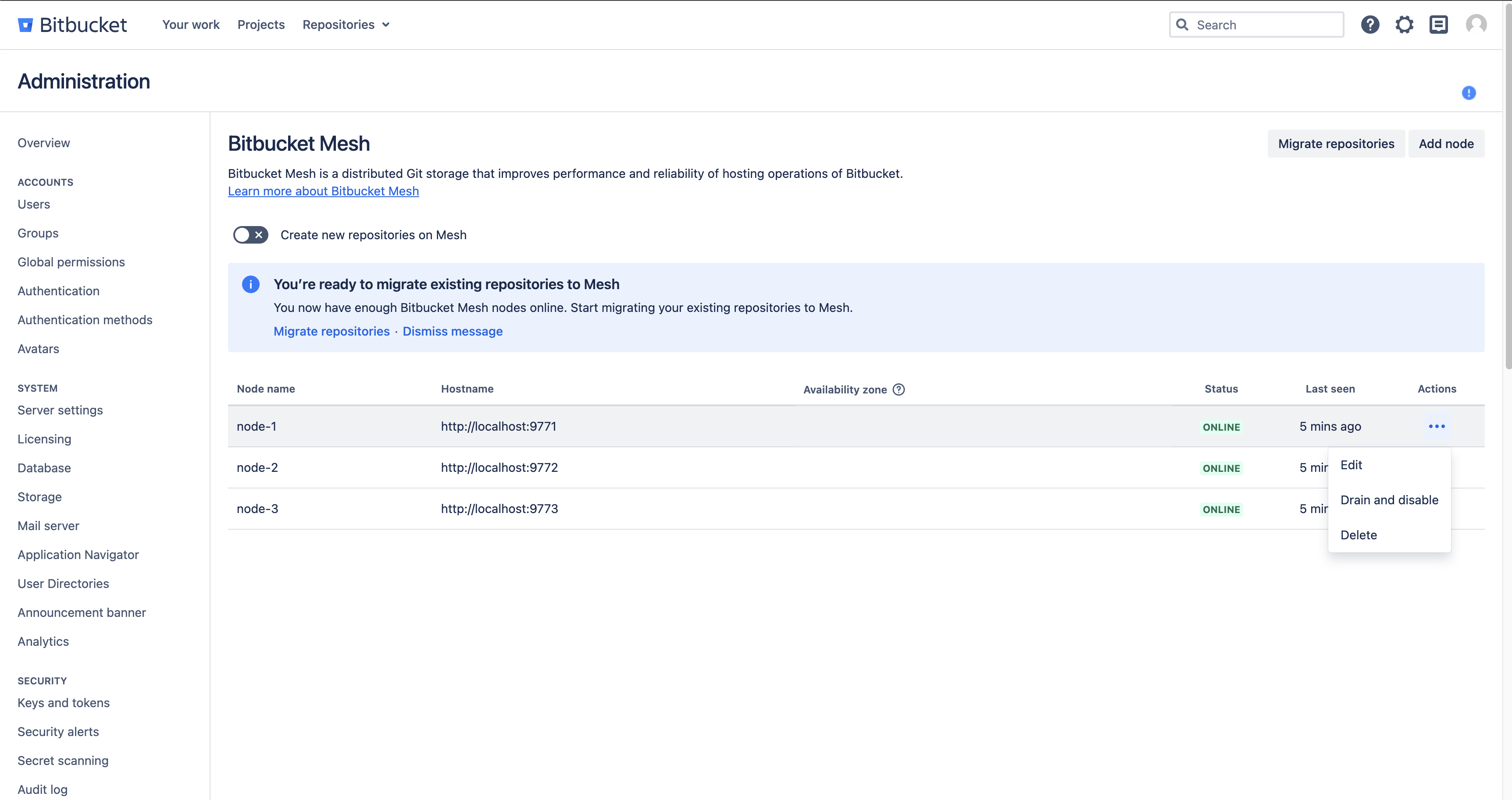

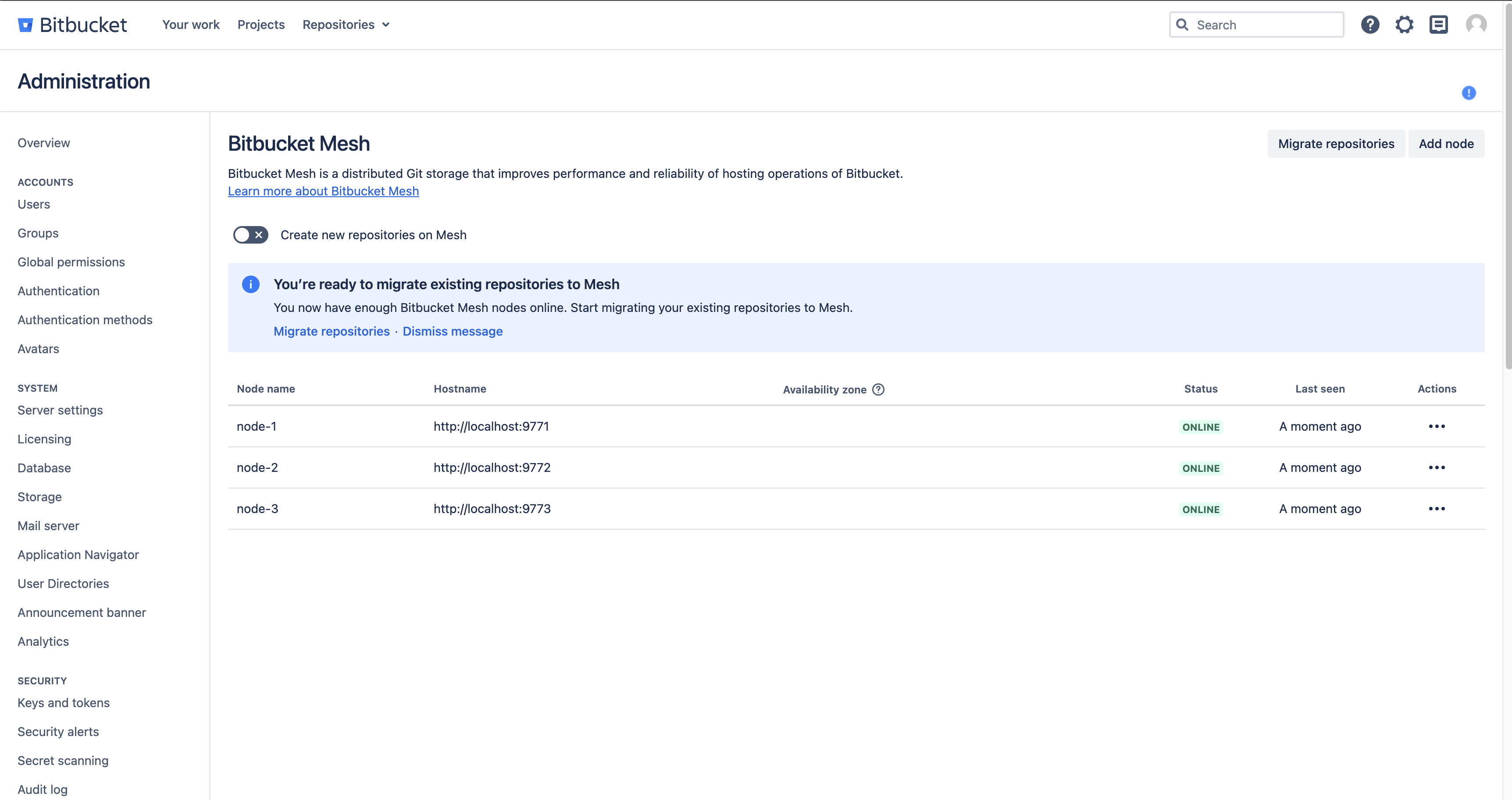

Navigate to the Bitbucket Mesh administration page where your list of registered Bitbucket Mesh nodes should already be displayed.
Bitbucket Mesh administration page with registered Bitbucket Mesh nodes having no availability zones
If you try to Edit via the meatball Actions menu one of the Bitbucket Mesh nodes and attempt to update the availability zone you will see the following:
Availability Zone field is read only for editing an already registered Bitbucket Mesh node
The availability zone field in the dialog box is read only when trying to perform an edit on the already registered Bitbucket Mesh node.

  3. To add an availability zone to the registered Bitbucket Mesh node, simply click on the meatball Actions item corresponding to the node you wish to modify.
    Expanding the Actions meatball menu options
  4. Click the Delete Actions menu item from the list for the registered Bitbucket Mesh node.

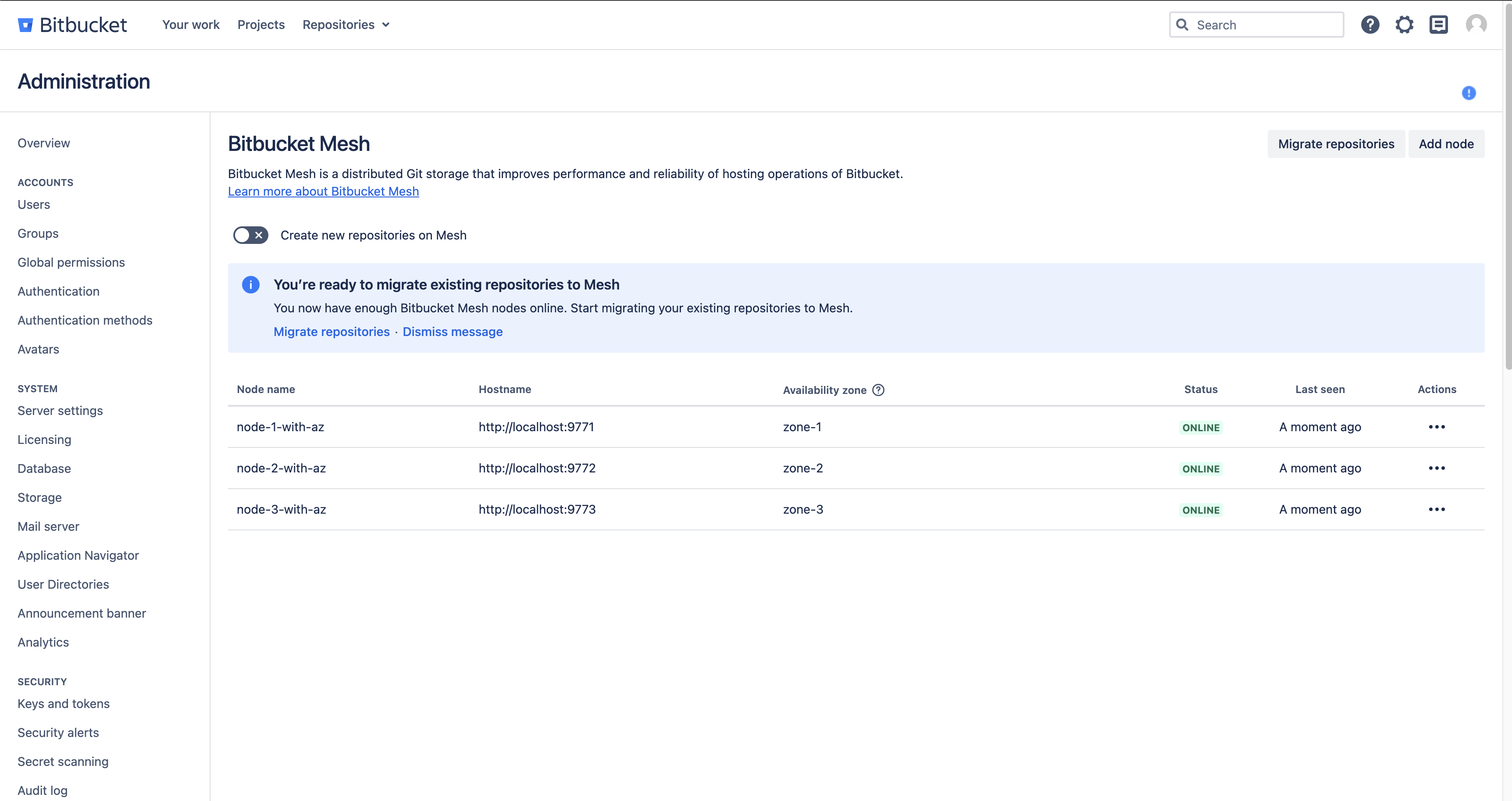

After you have made all the necessary changes to the registered Bitbucket Mesh nodes then your Bitbucket Mesh administration page will look something like the below with availability zone information:
Bitbucket Mesh nodes with configured availability zones
