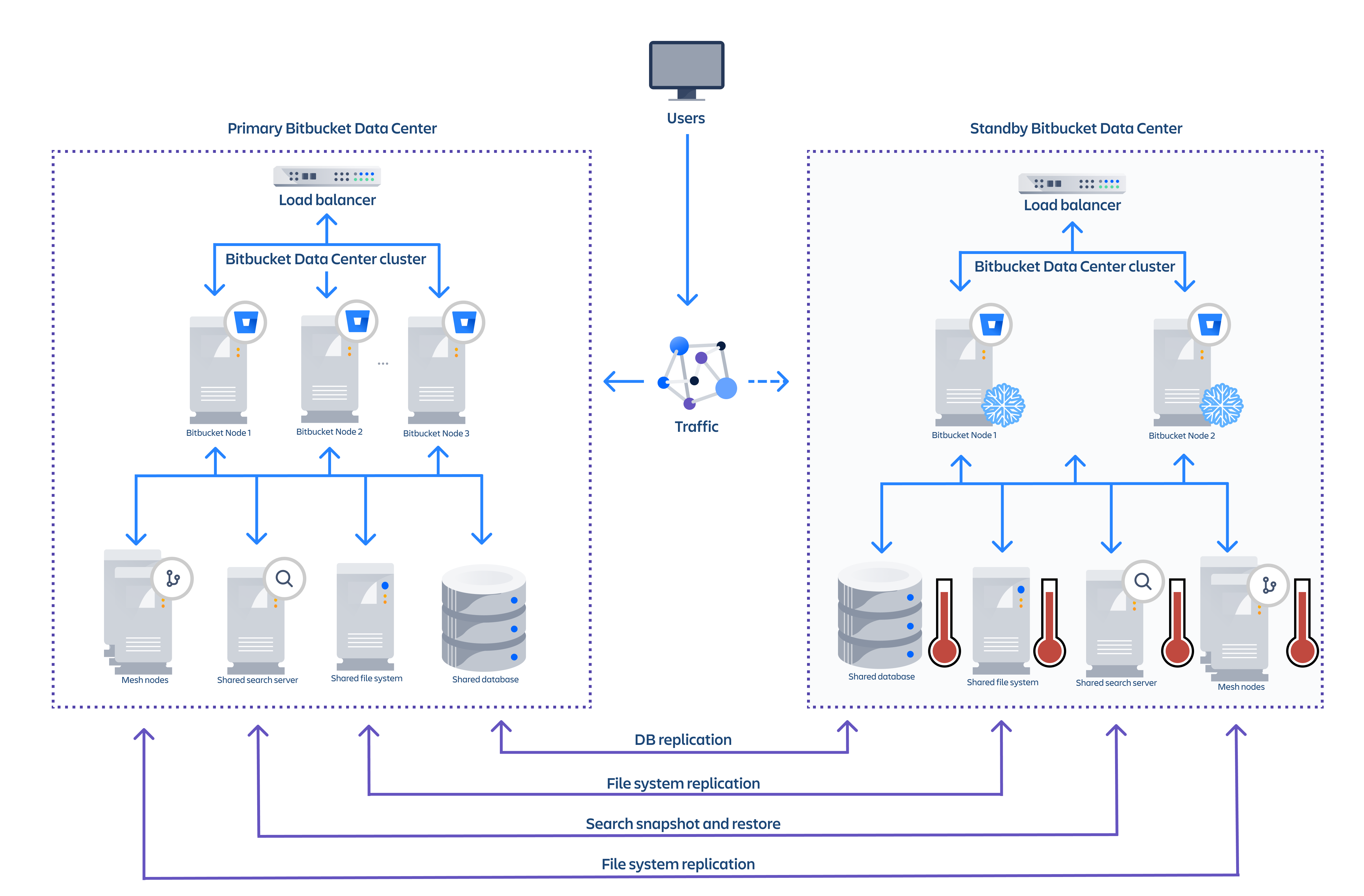

A typical deployment of Bitbucket with a standby for Disaster Recovery is depicted in the following diagram. The standby Bitbucket and Mesh instances are "cold" (i.e., not running) and the shared file server, database and (optionally) search server are "warm" (i.e., running) so that replication can occur.
Example component diagram of a typical DR deployment.
Replication of data sources
Replication of your primary Bitbucket system to a standby system requires:
  1. your shared home directory to be on a file system which supports atomic snapshot-level replication to a remote standby, and
  2. your database to be capable of replication to a remote standby, and
  3. your Mesh home directories to be on a file system that supports atomic snapshot-level replication to a remote standby, if you use Mesh for managing your repositories.
