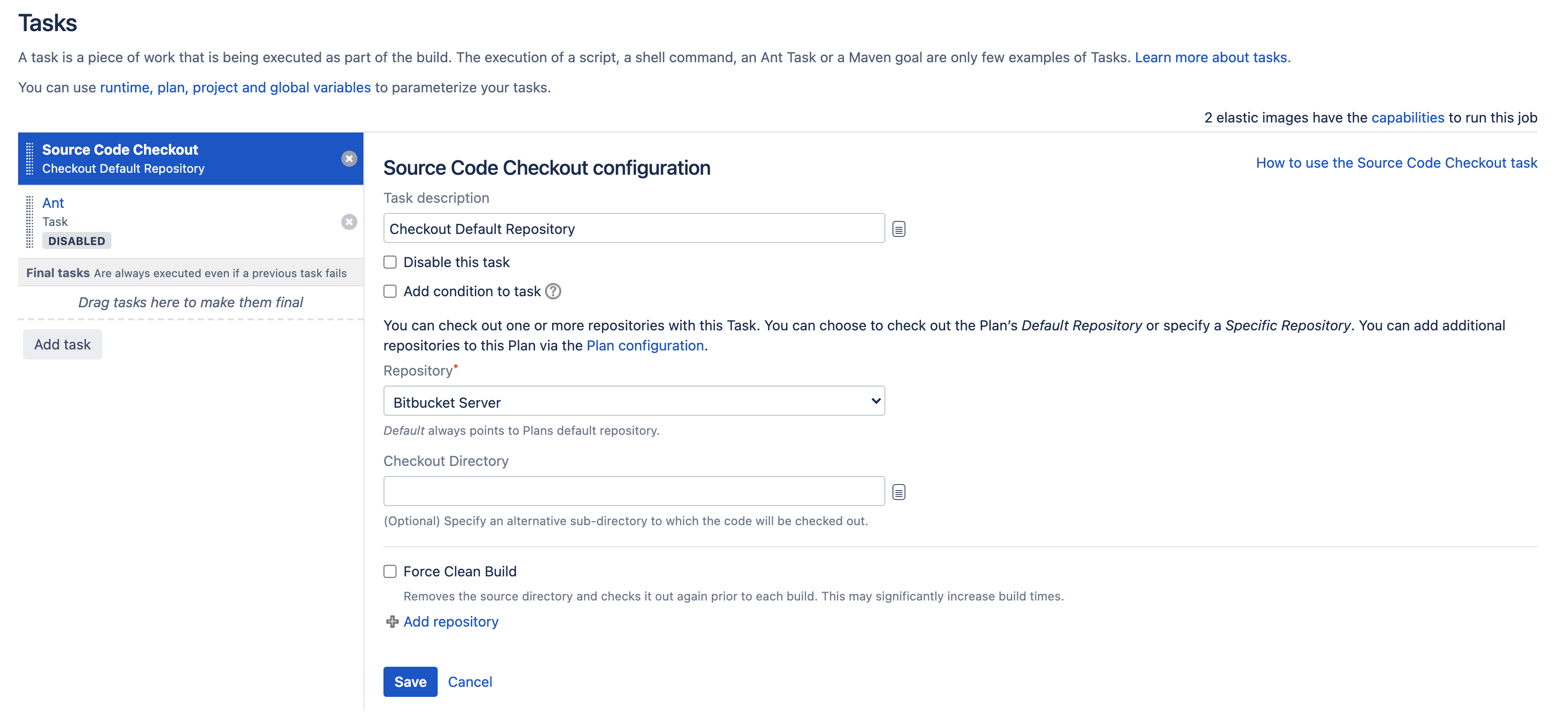

新しいソース コード チェックアウト タスクを設定するには、次の手順に従います。
- タスクを実行するジョブに移動します。
- Select the Tasks tab, and select an existing Source Code Checkout task in the tasks list, or add a new one using the Add task button.
Configure the task:
Task description
Enter a description of the task, for display in Bamboo.
Disable this task
Check, or clear, to selectively run this task.
Add condition to task
Make task run only when a certain condition is met.
You can find conditions on Atlassian Marketplace or implement your own.
Repository
Select the desired repository. If you wish to add different types of repositories, they must have been previously defined on the plan's Source repositories tab. See Linking to source code repositories for a list of supported SCMs.
Checkout Directory
The location to which the contents of the selected repository will be checked out to when the task executes.
Force Clean Build
Deletes the previously checked out directory and checks it out again prior to the next build. This may significantly increase build times.- Select Add repository at the bottom of the screen to check out another repository using this task.
