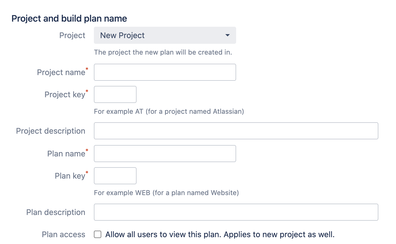

1. プランの詳細
Select Create in the menu bar, and then Create plan.
Every plan belongs to a project. We don't have a project yet, so select Project > New Project, and enter details for both the project and plan.
See Configuring plans for details.

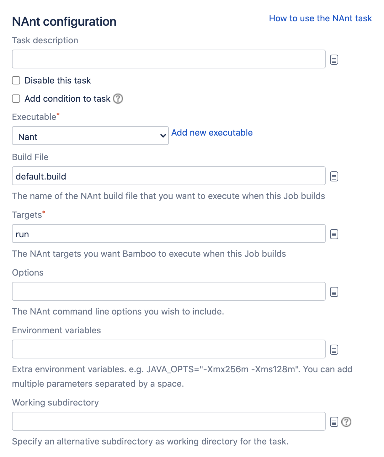

Select Add task, then Builder and choose the task that matches the build tool for your project. Expand one of the following sections to see configuration details specific to that builder task:
NAnt...
NAnt configuration section in Bamboo
NAnt に関する情報は、http://nant.sourceforge.net/ をご覧ください。
