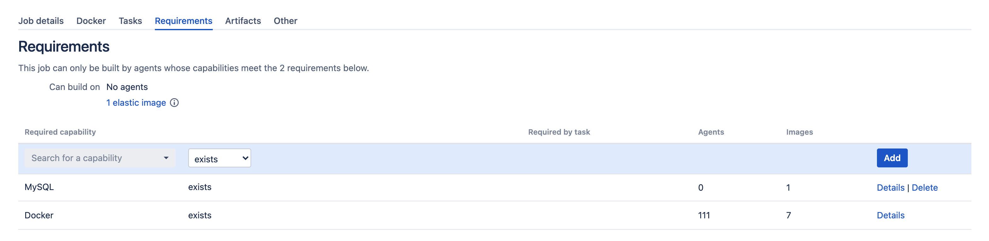

  2. Select the Requirements tab (see screenshot below). This page shows a list of all the job's current requirements and the number of Agents and Images (i.e. agents/elastic images which meet the job's requirements and can run a build for this job). See Viewing current capable agents below for more information.
  3. Search for a capability and select a requirement from the list.
  4. リストから要件の値を選択します。
    • exists (存在する) — このジョブは、同じキーを持つ機能を備えたすべてのエージェントがビルドできます。
    • equals (等しい) — このジョブは、同じキーと値を持つ機能を備えたすべてのエージェントがビルドできます。
    • matches — this job can be built by any agent that has a capability with the same key, and the value matches the regular expression. For more information about regular expressions, see Oracle's tutorial on regular expressions.
  5. Select Add. The numbers of Agents and Images will be updated, as the plan can now only be built by agents with capabilities that meet the new custom requirement you have specified.
Job requirements configuration screen
