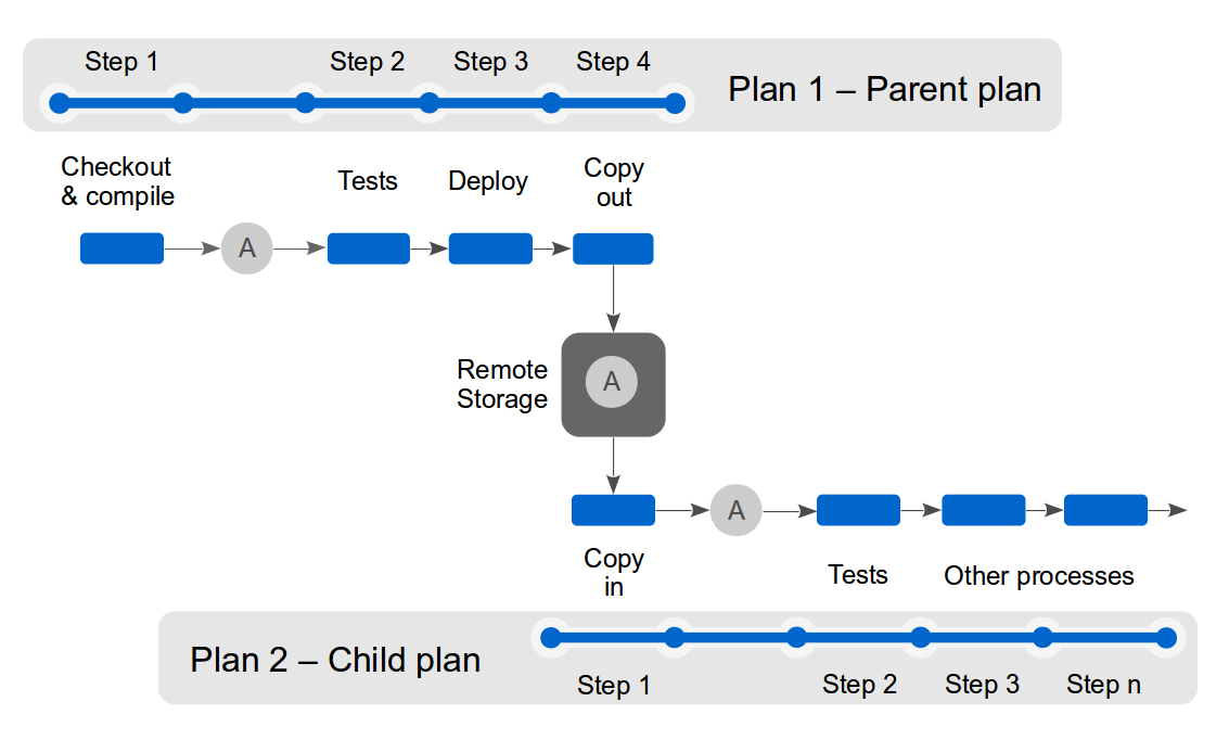

Let's consider the following artifact sharing example:
Imagine that we have a build plan that creates and uses an artifact - Artifact A. Now let's suppose that we also have a child plan, and we would like to use Artifact A in this plan for some other purpose. Bamboo doesn't technically allow you to share artifacts between plans (but watch this space), so we can use a work around to get our artifact shared into the child plan. We copy it from the parent plan to a remote storage location, then use the artifact download task to obtain it for the new plan. Note: this approach differs significantly to the process for sharing artifacts between jobs.
Parent plan
Step 1: Checkout & compile - We need to check out the relevant code from the repository and compile it into an artifact. Our artifact is now defined and available for use by downstream jobs. Let's give it a name - Artifact A - and specify its location, so downstream jobs can find it, though of course only jobs in downstream stages can consume it.
Step 2: Testing - We can use some fail fast methodology and run some tests on our artifact before we go any further. We can conduct short and rapid unit tests and longer functional testing on our artifact. But we already know that artifact sharing can be used to increase testing speed in both cases.
Step 3: Deployment - When testing is complete, the artifact can be deployed to a QA environment by a consuming job that runs a deployment script against it, but we still need to share it with the child plan.
Step 4: Copy artifact out - The final step of this plan is to use a task to copy the artifact out to a remote location such as Nexus or Artifactory, using the applicable Bamboo plugin. Alternatively, simply run a script task to copy the artifact to a remote file server location on your own network.
Child plan
Step 1: Copy artifact in - The first step of the child plan is to use a task to copy the artifact in from where the parent plan left it. Depending on the method you used to copy it out, you may require a task that utilizes a Bamboo plugin.
Step 2: Business as usual - Now that we have copied the artifact in, we can perform regular Bamboo operations as part of an ongoing build plan. These could be additional tests, or deployments into different environments.
Extending artifact sharing
And of course, once we have our artifact neatly stored in remote storage, the artifact download task means that it can associated with any build plans that we may want to run.
