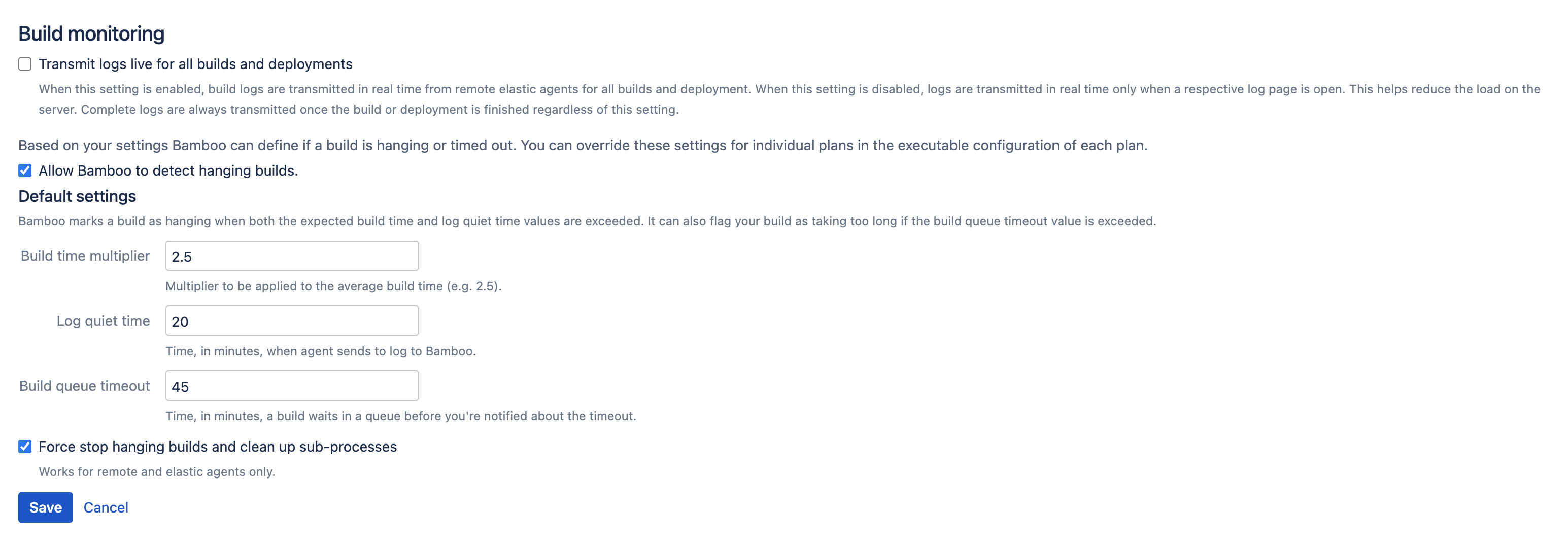

  1. In the upper-right corner of the screen, select
    Administration bamboo administration icon
    > Overview.
  2. Under Plans, select Build monitoring.
  3. Select Edit and update the values for Build time multiplier and Log quiet time as required.
  4. 保存 を選択します。
Build monitoring page
