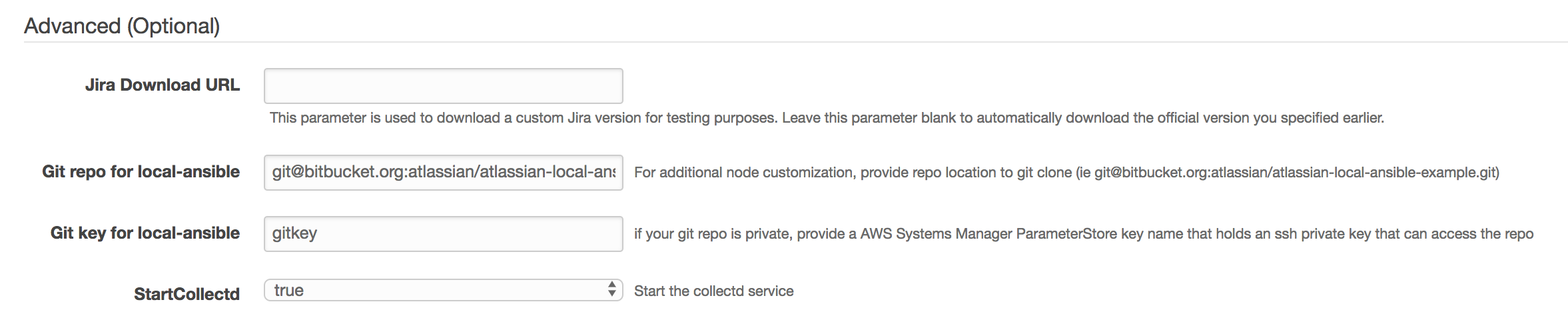

When deploying any of the product Cloudformation templates from https://bitbucket.org/atlassian/atlassian-aws-deployment/src/master/templates/ there are two relevant fields to leverage the ansible exit point.
  1. You should fork the atlassian-local-ansible-exmaple repo and modify it to suit your needs
  2. If your forked repo requires credentials to access, upload a ssh public key that can pull from your repo to AWS Systems Manager parameter store as a "secure string"
  3. in the two Git template fields, provide the repo and paramater name
  4. As your stack instantiates it will attempt to bootstrap the local-ansible repo you have referenced in the template
