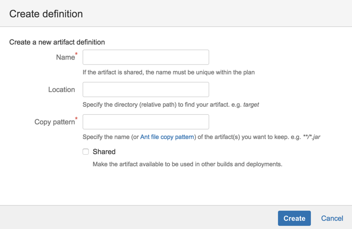

Shared/Unshared artifacts
When Configuring a job's build artifacts, you are able to make it consumable OR not by - the same plan, other plans, deployment environment. What defines this feature is the Shared in the Artifacts >> Create definition view, which Make the artifact available to be used in other builds and deployments.
Once having a successful build that produced an artifact, you can run the following SQL statement to check where the same can be found under the <bamboo-home>/artifacts
directory:
